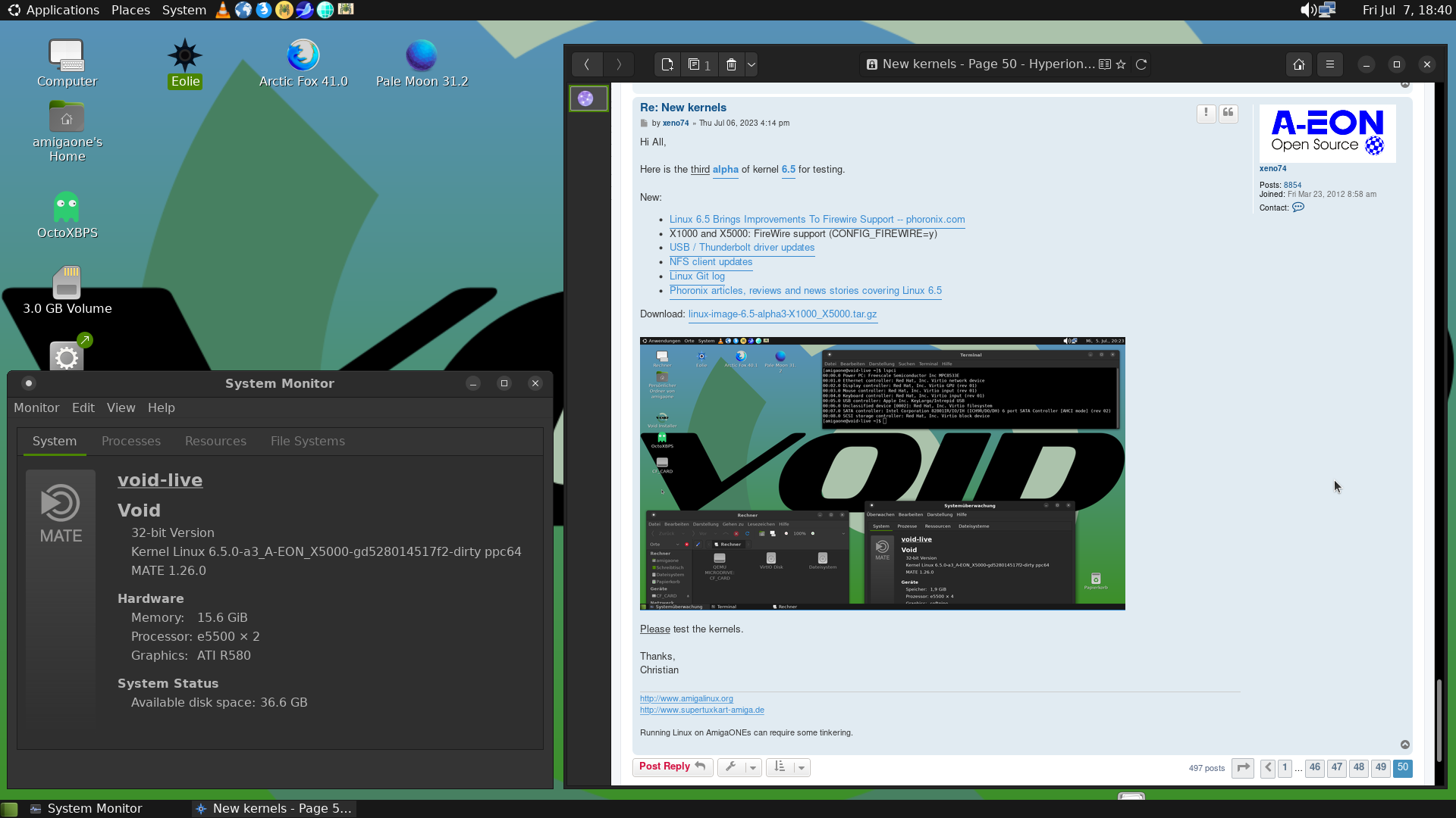

Posts: 971
Kernel 6.5 Alpha3 up and running on my AmigaOne X5000
Big picture https://www.skateman.nl/wp-content/uplo ... -40-41.png
Posts: 11139
Skateman wrote: Fri Jul 07, 2023 7:44 pm Kernel 6.5 Alpha3 up and running on my AmigaOne X5000
Many thanks for testing the alpha3! :-)
